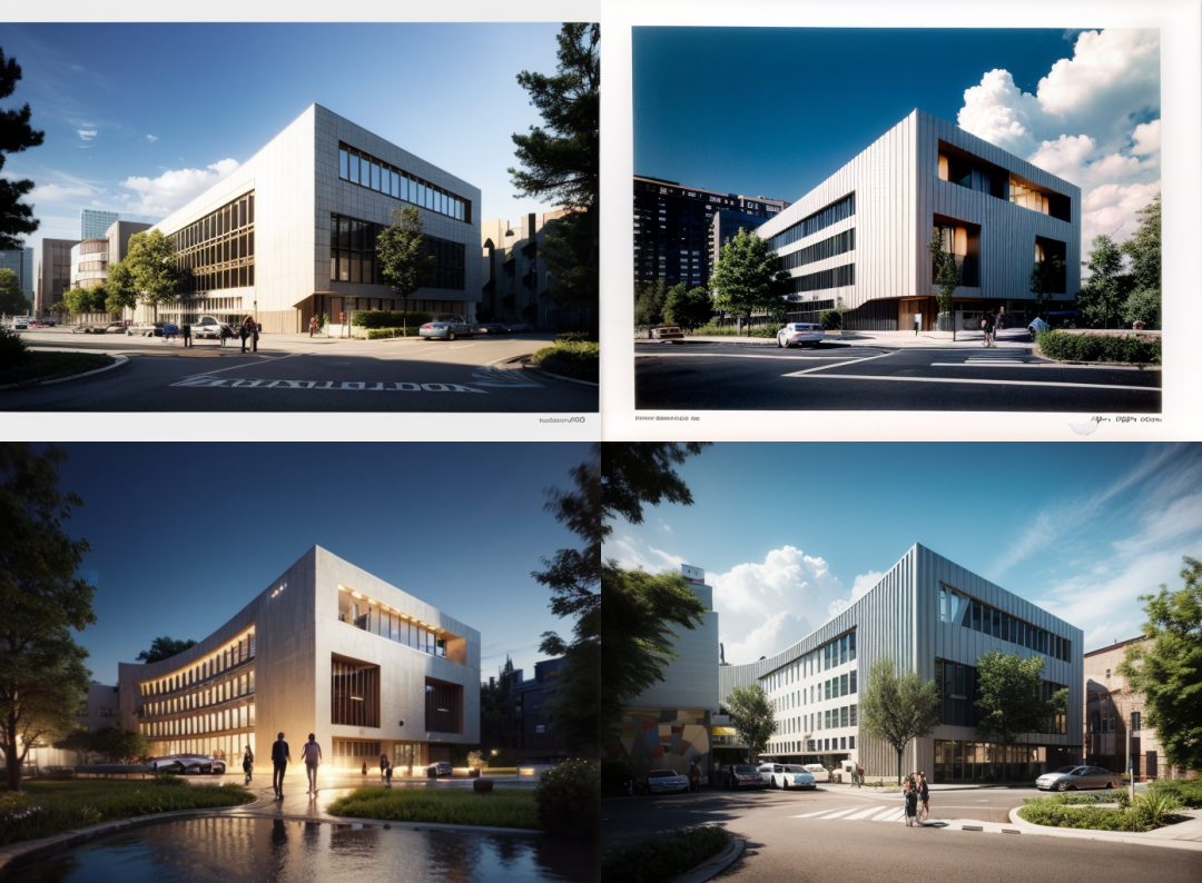

二、成果展示
图片白天效果有变化
图片夜景
图片加景观lora之后的效果
图片预处理器权重为1效果

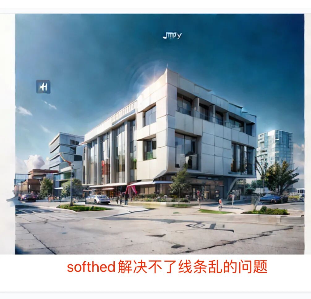

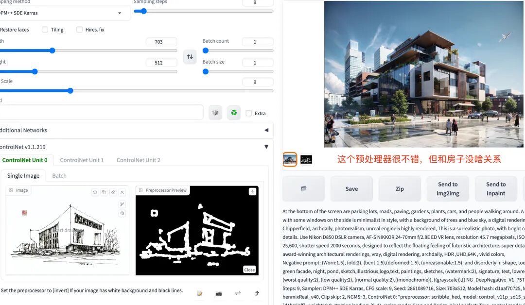

预处理器采用Scribble的效果

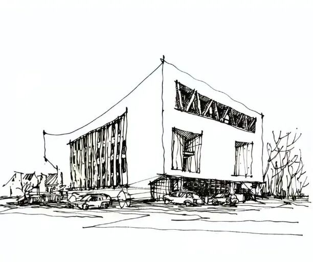

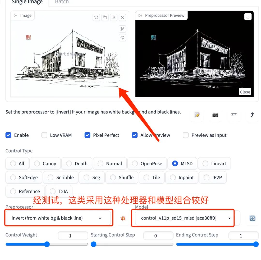

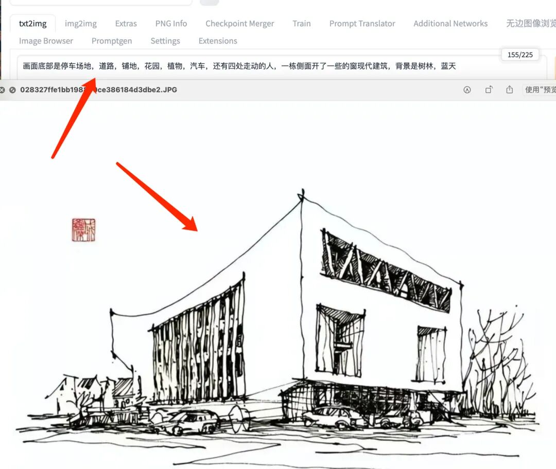

1、一张草稿
2、用到的模型,仍然是henmixReal_v40.safetensors,C站可以下到

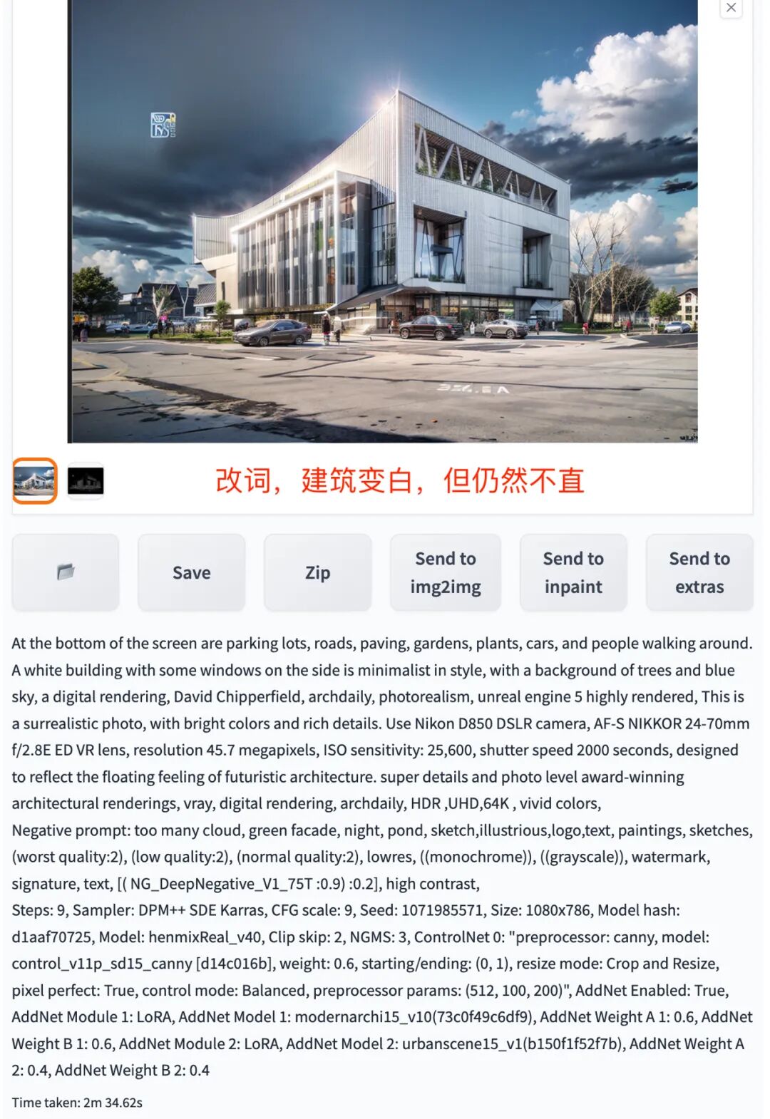

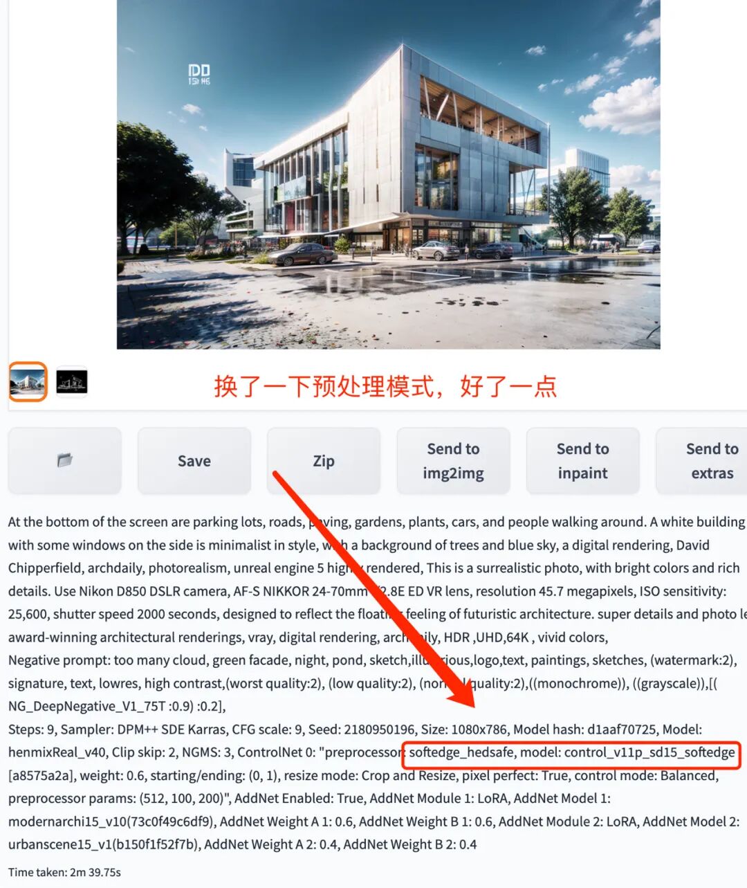

1、填写如下提示词
At the bottom of the picture are parking lots, roads, paving, gardens, plants, cars, and people walking around. A white building with some windows on the side is minimalist in style , and Tall Narrow Windows On the left side of the building , and on the top of the right side is a full-length strip window, and the rest are rectangular windows, with a background of trees and blue sky, a digital rendering, David Chipperfield, archdaily, photorealism, unreal engine 5 highly rendered, This is a surrealistic photo, with bright colors and rich details. Use Nikon D850 DSLR camera, AF-S NIKKOR 24-70mm f/2.8E ED VR lens, resolution 45.7 megapixels, ISO sensitivity: 25,600, shutter speed 2000 seconds, designed to reflect the floating feeling of futuristic architecture. super details and photo level award-winning architectural renderings, HDR ,UHD,64K , vivid colors,

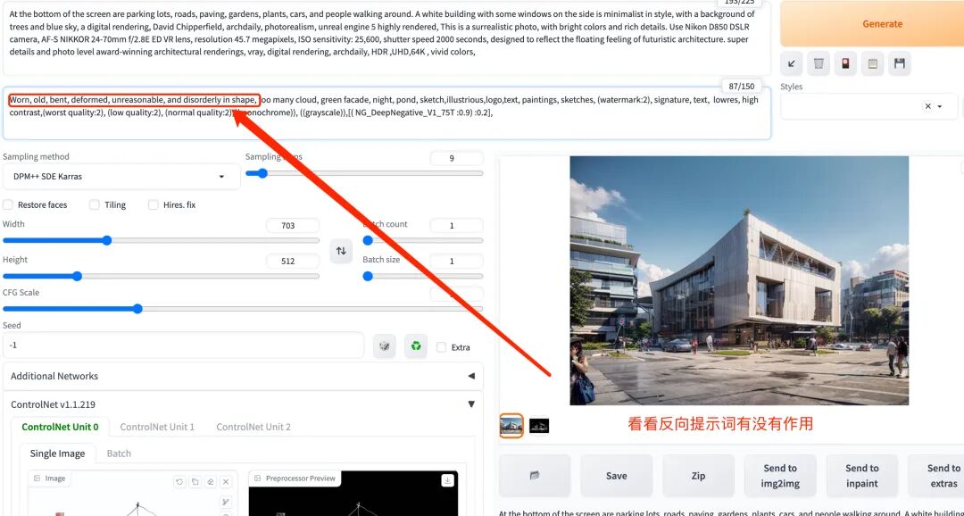

Negative prompt: Tree blocking building facade, too many cloud, green facade, night, pond, sketch,illustrious,logo,text, paintings, sketches, (watermark:2), signature, text, lowres, high contrast,(worst quality:2), (low quality:2), (normal quality:2),((monochrome)), ((grayscale)),[( NG_DeepNegative_V1_75T :0.9) :0.2],

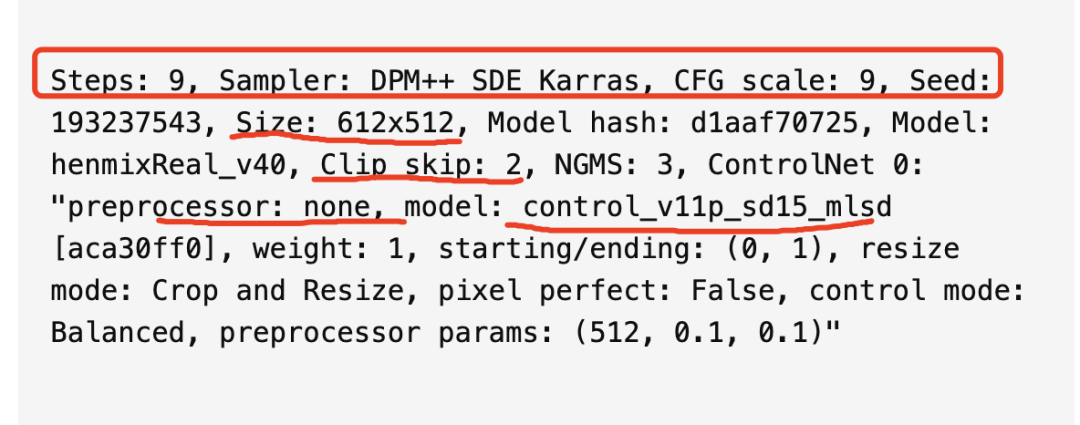

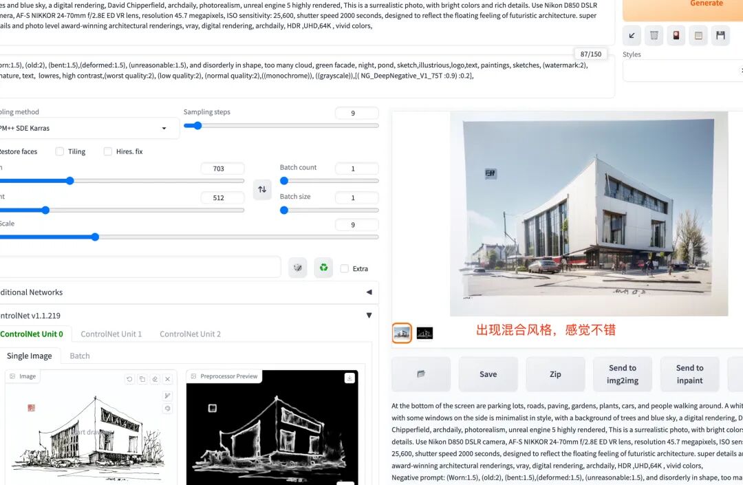

2、生图参数如下

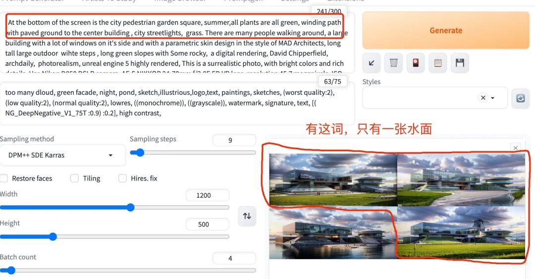

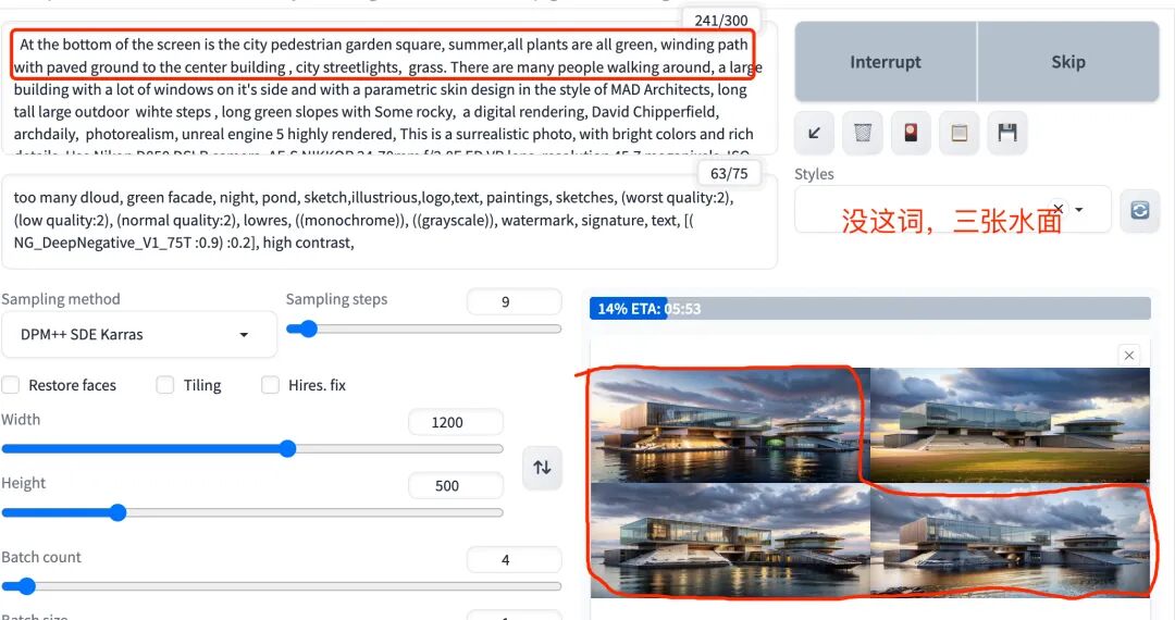

2、提示词写法简介
描写画面中上下左右中间各个方位上的图画内容,SD会给一定的回应,背景描述会很好的回应,颜色会给很好的回应。

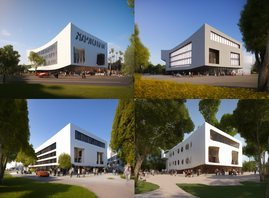

选择对你的描述敏感的模型,测试方法最快,一般是四张就可以看出来。
图片不好的大模型生成的图

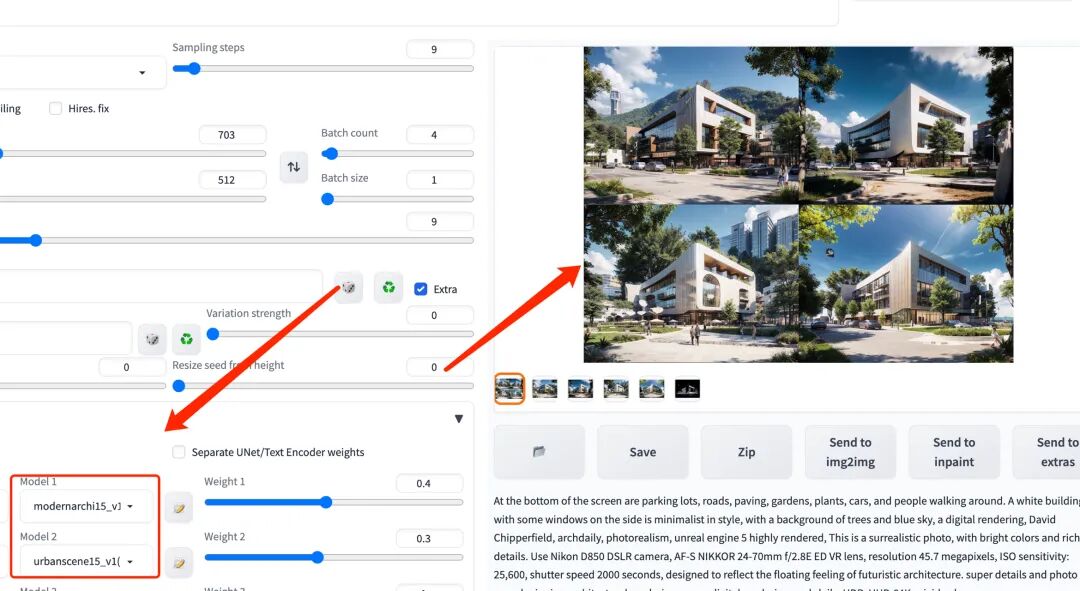

图片好的大模型生成的图
加Lora模型测试,效果有点乱,控制不了形体
