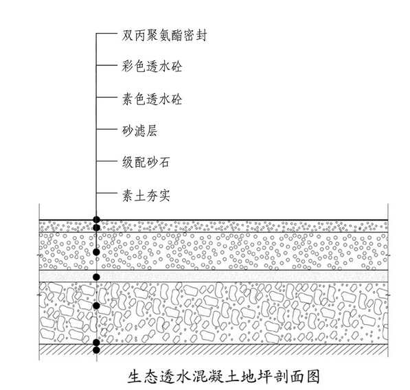

彩色透水混凝土路面施工工艺
https://ziliao.co188.com/p62312878.html
