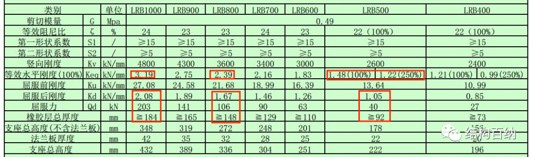

图片隔震支座样本一图片
等效刚度=203/(1*184)+2.08=3.18
等效刚度=106/(1*148)+1.67=2.39
等效刚度=40/(1*92)+1.05=1.48
等效刚度=40/(2.5*92)+1.05=1.22
屈服后刚度=0.49*3.14*(1000^2)/4/184/1000=2.09
屈服后刚度=0.49*3.14*(800^2)/4/148/1000=1.66
GBT 51408-2021 建筑隔震设计标准

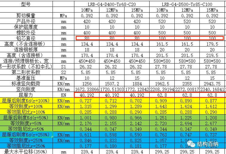

图片隔震支座样本二图片
屈服力=8*3.14*80^2/4/1000=40.192
屈服力8*3.14*100^2/4/1000=62.8
tr=239.4/3.5=68.4
等效刚度=40.192/(1*68.4)+0.727=1.315
等效刚度=40.192/(0.5*68.4)+1.001=2.176
等效刚度=40.192/(2.5*68.4)+0.611=0.846
